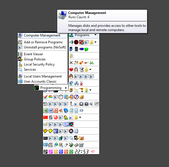

BUG 1: Two days ago I added a secondary monitor to my computer and found that tear-off menus don't work correctly in the secondary monitor, where sub-menus always open to the left even if the tear-off menu is not near the right-hand edge of the screen. Please see attached screenshots: "Correct.png" is what I get on the primary monitor, and "Wrong.png" is what I get on the secondary monitor.
As you can see, when on the secondary monitor submenus pile up on top of each other, while on the primary monitor the open always to the right until the screen edge is reached.
