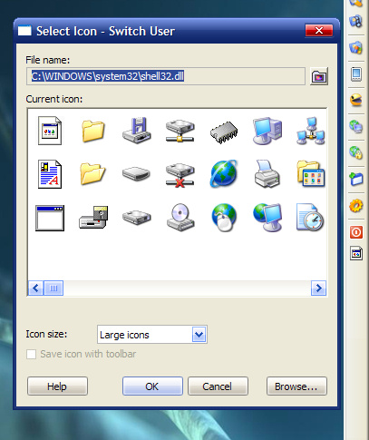

No icon changer software used, all that I've been doing with those TLB shortcuts is just creating a shortcut, and using the Appearance > Change Icon feature to change the icon to something from shell32.dll.
The shortcut icon is fine if I create the same shortcut on the desktop, though if I drag and copy one of the "broken icon" shortcuts from TLB to the desktop, the shortcut icon reverts back to the original one from the program the shortcut goes to.
I've attached a screenshot of the Select Icon dialog for the bottom most shortcut (with broken icon), notice how it's seemed to have "forgotten" which icon it's supposed to be displaying? The ones that work will highlight the selected icon and show "shell32.dll,17" or likewise at the bottom.
