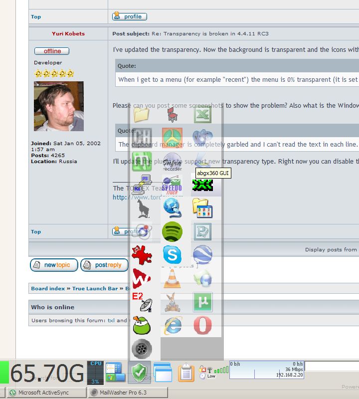

Here's a screenshot of the recent menu, I've hovered the mouse over the icons which are opaque and when I took the screenshot it was over the AGBX icon where the tooltip is

What skin do you use?
07-24-2010, 12:47 AM -
I guess the problem in the "Slide" effect for menu. Try to turn off the menu animation. In the next version this bug will be fixed. Thank you.
