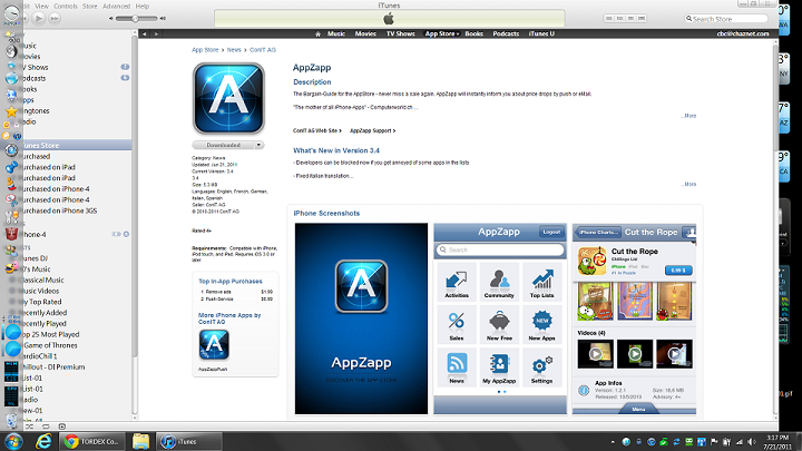

I am using the standalone version of TLB 5.6 64-bit and have just installed the newest version of iTunes 10.4
I have TLB configured as always on top/locked/taskbar mode and docked on the left. Prior to the most recent iTunes, it worked fine. iTunes isn't seeing the 'always-on-top' setting of TLB and when in fullscreen view, it rests under TLB, with the width of TLB of screen showing on the right. Other applications still work as before, so far it's just iTunes 10.4 (64-bit).

I've tried the itunes 10.4, it is working well here. Maybe I don't understand you clearly. Please can you post the screenshot of the problem? What is the "fullscreen" for iTunes? Is this maximized window?

Yes, it's when iTunes is in fullscreen. It's as if TLB thinks it's supposed to be docked on the right and makes space on the wrong side of the screen.

Thank you very much for the screenshot. I've reproduced this bug. iTunes don't like toolbar at the left side of the screen. It set the correct window width (as you see the right border of the itunes window have an empty space for toolbar) but the position is incorrect. This bug can be reproduced even if move the taskbar to the left side of the screen.
So as temporary solution you can move the toolbar to the right side.
Unfortunately I cannot to fix this bug Sad . You have to report this bug to the Apple iTunes support. This is the bug of iTunes. I hope they will fix it shortly.
