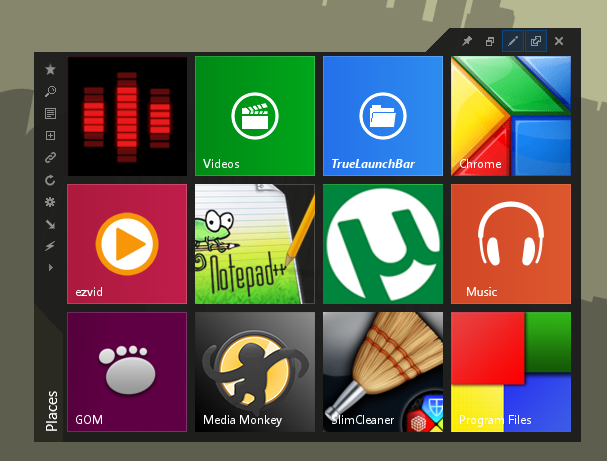

Please can someone try this to see if it is worth continuing. It converts TLB buttons to Windows 8 style tiles using a simple right click.
Any problems getting it to work please let me know. Follow the instructions!!
- mls

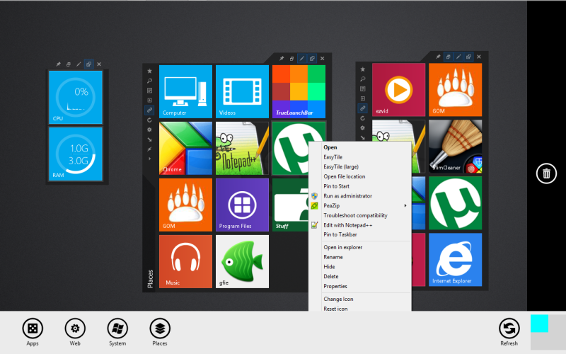

On the attached screenshot is my new menu Big Grin

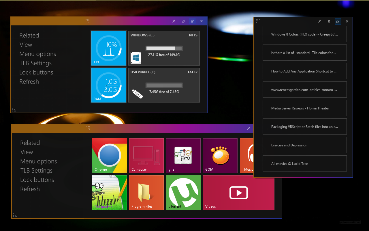

See the video!
https://www.youtube.com/watch?v=a3WjygbC2J4
Screenshots:
This post was last modified: 01-17-2013, 09:53 PM by mls.

01-17-2013, 09:51 PM -
Some new features. If anyone wants them i'll package it up and upload it.
1. Nearly all the TLB Button Properties will work on tiles too. I.e. Show/Hide icon and text, text alignment, text color, bold, italic, icon size, icon location (You can change the icon at the shortcut level too)
2. Special icon sizes:
0 - normal
1 - original
2 - smaller
3 - small
4 - normal
5 - big
6 - full
7 - oversized
TIP: You can use an image as the icon so if you find a 120x120px tile image on the web you can set it as the icon with icon size = 6 (full) to get the same tile when you run easytile.
3. New context menu options EasyTile (Large)
4. Quick edit mode using either left or middle click on a tile.
5. New skin (see screenshot)

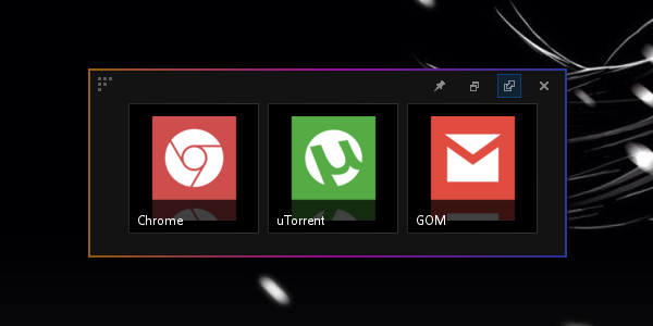

01-24-2013, 11:01 PM -
1. Unzip
2. Open a command prompt as Administrator and cd to the extracted folder.
3. Run easytileinstall.vbs
(Hey Yuri, if you want to write an nsis installer for this, feel free.)
EasyTile only works for shortcuts in non-virtual folders.
Right click on a shortcut and choose "EasyTile" or "EasyTile (large)" to create a tile.
Shift-right click shows "EasyTile - use left click" and "EasyTile - use right click".
- use middle click will run EasyTile on middle click.
- use left click will run EasyTile on left click and EasyTile (large) on middle click.
Change a tile icon either by changing the shortcut icon or using TLB (Change Icon or Button Properties) then run easytile again.
Use TLB Button Properties for other tweaks and to change the icon size.
Set icon size to an actual icon size e.g. 96 or use the special icon sizes 0 - 7 as explained above.
Tips: use any png icon or image, 256x256 work well, does not have to be square either.

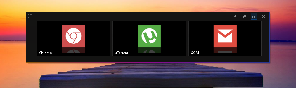

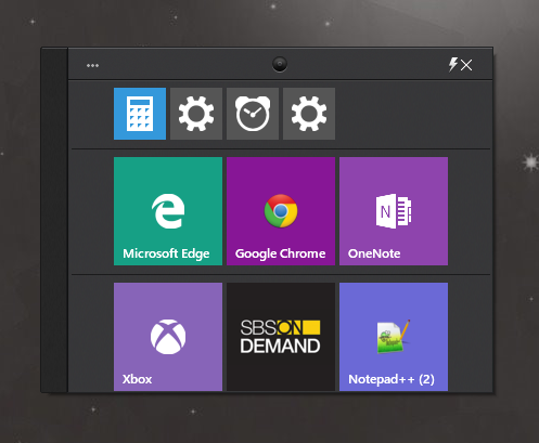

01-25-2013, 02:32 AM -

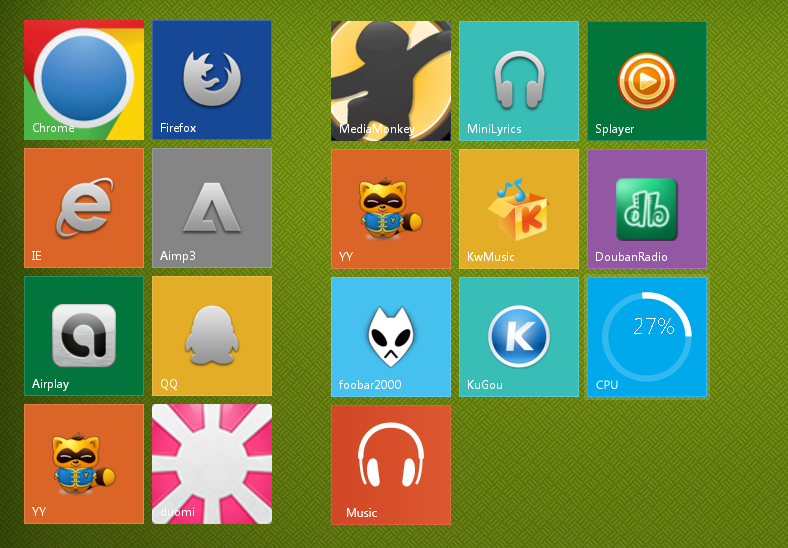

With reflective icons
This post was last modified: 01-25-2013, 02:36 AM by mls.
