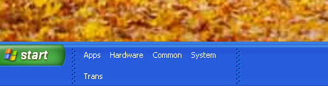

I have XP Home and a two-row taskbar. When I had 4 TLB menus, it looked like this:
Apps Hardware Common
System
Now, I have 5 TLB menus, and it looks like this:
Apps Hardware Common System
Trans
As you may have figured out, in order to save real estate, I would like it to look like this:
System Trans
But no matter how much I try to move the right-margin dotted line to the left, I cannot make the toolbar this way.

Quote:But no matter how much I try to move the right-margin dotted line to the left, I cannot make the toolbar this way.
What you get when drag line to the left? Please can you post the screenshot of your toolbar.

This is a far as I can drag the right-side dotted bar to the left.

08-13-2007, 06:21 AM -
This is the bug. I'll fix it in the next version. Thank you.

08-13-2007, 06:29 AM -
As temporary solution: open TLB Settings->Toolbar and set the value Minimum size into 1

08-13-2007, 07:45 AM -
Thanks, worked.
