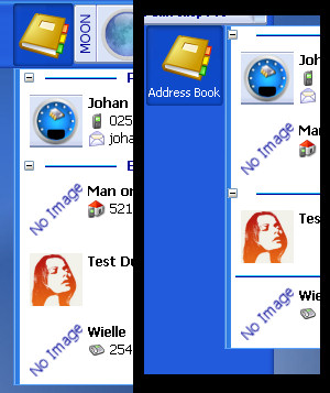

i just moved it (Address Book) from one 'Standalone TLB' to another and in this process all the titles disappeared. when i move them back after recreating the titles on the new TLB the second title moves one down. is this maybe because menu information is only saved with toolbars. it is very frustrating to loose all formatting when you just want to move a menu to a new toolbar.

i include here a screenshot of what happened when i added the titles again on the new TLB. can you please tell me why the expand icon is so far to the left on the right-hand image. i checked to ensure both TLB's settings are the same.

Quote:i include here a screenshot of what happened when i added the titles again on the new TLB. can you please tell me why the expand icon is so far to the left on the right-hand image. i checked to ensure both TLB's settings are the same.
What skin do you use? Please can you send me a backup of the toolbar? I can't to reproduce the bug on my side. Maybe this depends of some your settings.

Quote:What skin do you use? Please can you send me a backup of the toolbar? I can't to reproduce the bug on my side. Maybe this depends of some your settings.
my skin is the default skin of TLB (i like the Windowz look) and i only changed the colours of the titles and separators on menus. it displays correct on all other toolbars, so i assume it to be a setting... i will play some more and let you know. interesting though the last time i dragged it back to the faulting toolbar the icon became one of the other button images and not even 'Reset Icon' would change it back. after dragging it to another toolbar and back the icon was restored.
