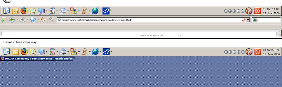

Question : in the launch bar the Icons/Menu's are not aligned to the left but they are 'spread' over the width of the screen ... maybe it is taste ... but it looks 'ugly' ... how can I align them to the left? Now there 'are' empty places between the icons ... or is this in the evalutation version only?

in attach a screenshot ...
... the 'Move to the right' option ... dont' know what it does ... maybe on Icon level only ...
... the alignment of the 'bar' ... the bar is 'lengthy' .. it splits over two lines ... second line is aligned to the right ... I feel it should be to the left ...
... if the 'bar' is one line then the icons are 'spread' over the line ...
I just received my registration code ... no change ...
What I'm I missing ... maybe it is normal behaviour?
02-11-2005, 09:58 AM -
The problem in the "Move to the right" option on one of the buttons. Begin from the first button one of the buttons have this option. Also you can send backup of toolbar to me (<!-- e --><a href="mailtoConfusedupport@tsoftcentral.com">support@tsoftcentral.com</a><!-- e -->) and I'll find this button for you.
