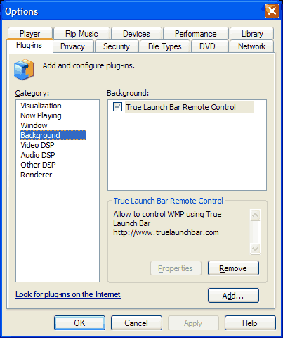

I do not know about problems with WMP10. It must be compatible with WMP9. Please can you check the WMP options for the TLB remote plugin (see screenshot)

how do i keep making these mistakes and constantly causing false alarms? :oops:
i feel like crap Yuri, the plugin was unchecked (i dunno how that happened since i didn`t do it and none else has acces to my machine)
When i checked it everything is working fine
:oops:
Sorry once again for causing the false alarm Sad
01-06-2005, 03:09 PM -
Plugin can be unchecked when it crash WMP. But WMP must ask you about this.
