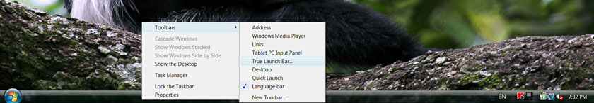

No, Sir, am sorry.
When I click on the TrueLauncBar (see attached screenshot), nothing happens. It does not appear anywhere, and when I open this pop-up menu next time, it is not checked again :(
I had already uninstalled and reinstalled the program tonight, but nothing new happened. It even did not appear at the upper part of the screen at the first start as before. Seems that the previous settings have been remembered somehow somewhere, dispite the use of the cleaning utilite you provide...
Other suggestions?..
