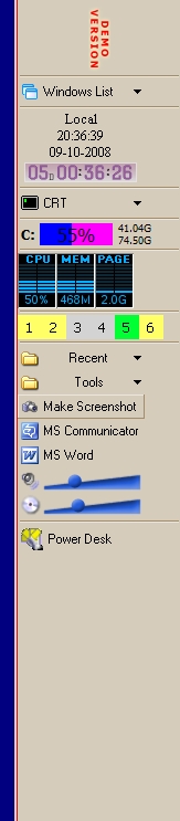

When I do NOT have the use global settings checked, my toolbar looks like attached file 1. There is an icon, name and the menu arrow on the same line. This is what I want.

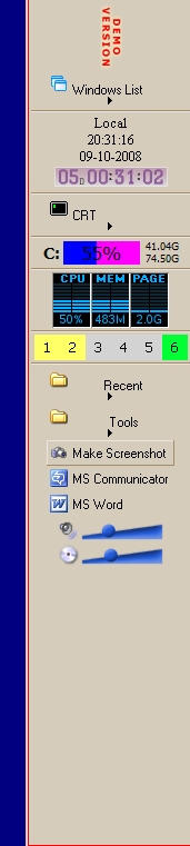

When I DO have the global settings checked, my toolbar looks like attached file 2. There is an icon, name on one line and the menu arrow in on a second line. This is NOT what I want.
I have tried to find an option that controls this, but can not locate it.
09-11-2008, 12:22 AM -
Do you use version 4.2.7?
I guess this is because of the skin you are using. Please can you send me the file "setup.ini" from the folder %APPDATA%\Tordex\True Launch Bar\settings

09-12-2008, 01:35 PM -
Please can you send me the backup of the toolbar when it is incorrect? Send it by email (<!-- e --><a href="mailtoConfusedupport@truelaunchbar.com">support@truelaunchbar.com</a><!-- e -->) I can't to reproduce the bug with setup.ini only Sad
09-15-2008, 12:22 PM -
Thank you very much for backup file. I've reproduced the bug. I'll fix it in the next version. Generally this is not a problem with the global settings. You can to avoid this problem: right-click the empty space of toolbar and set the check mark on the "Show text" menu item.
