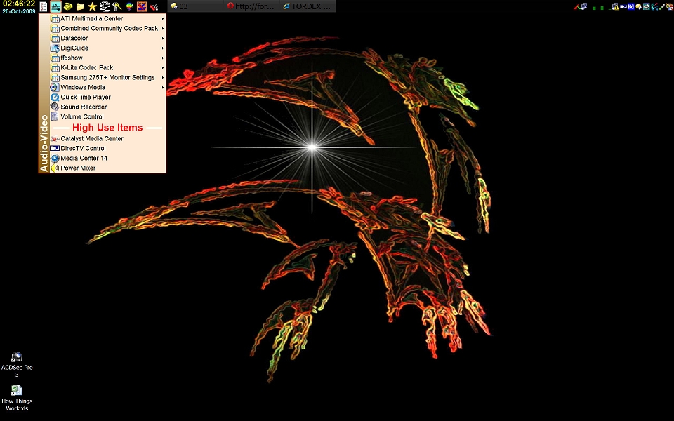

If I accidently drag a TLB menu icon from the Quick Launch area of the Taskbar onto the desktop the custom icon is lost. Dragging it back onto the TLB list will not restore it. It has to be manually re-applied. THIS IS ALSO AN OLD PROBLEM.
Quote:Just hold down SHIFT key when dragging it back to move menu back to TLB (by default TLB creates the shortcuts). Or drag with the right mouse key - TLB will show the menu.
BTW, you can lock the buttons to prevent the unwanted dragging.
Been there, done all that, no joy.
What happens is once the TLB menu icon is dragged onto the desktop it reverts to the generic yellow folder icon and my custom applied icon is lost.
I learned the hard way (after this happen several times) to always lock TLB menus. This unfortunately also prevents me from making changes to the menu by dragging and dropping so I have to unlock the menu, make the change and remember to re-lock the menu.
What has happen (more than once) is I will unlock the menu, make the change and forget to re-lock it thereby leaving TLB prone to the accidental dragging of the icon onto the desktop which reverts to the generic yellow folder icon.
This should not even be an issue, the icon should not revert to the generic yellow folder icon no matter where I drag it. If it did not change I could simply drag it back onto the TLB bar with no problem.
Pleas keep in mind that the accidental dragging of the TLB menu icon is a little more prone to happen on my system as I have the Windows Taskbar on the TOP of my screen (APPLE like). This means that the top of my screen is very busy with a lot of menus TLB and other running programs so the chance of doing an accidental drag is higher than if the Taskbar was on the bottom of the desktop.
See JPEG.
Doc

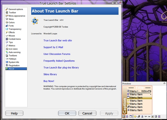

Hmm... strange, the icon for the menus must be saved on moving between toolbar and desktop. Do you use TLB version 4.4?

Yes, I am using 4.4.

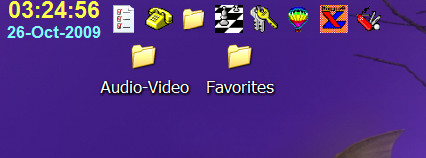

See the JPEG of two icons that I just dragged to the desktop; they both reverted toi the generic yellow folder.
Doc

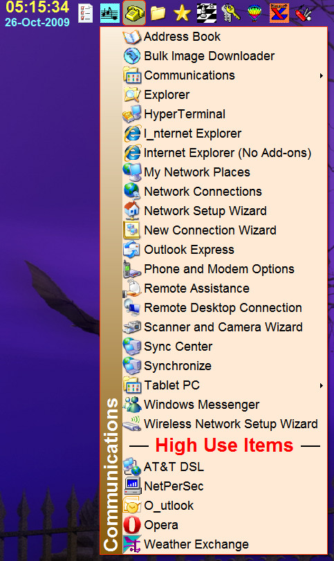

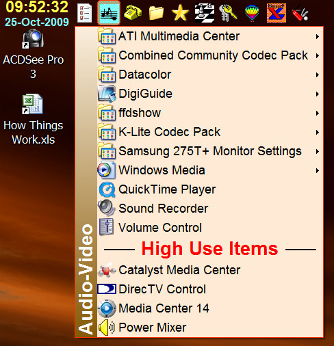

Original Custom Icon Set.

TLB version JPEG.

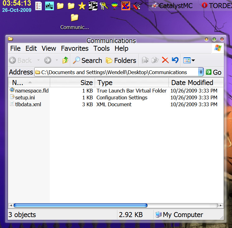

DocCruncher
10-26-2009, 12:56 PM -
THAT is the problem; once it reverts to the generic yellow folder icon (by dragging to the desktop) it stays a yellow folder icon when dragged back to the TLB toolbar; the custom icon is lost.
Not only that but the whole menu that was dragged onto the desktop is also lost. Dragging the yellow folder icon back onto TLB toolbar results in ONLY an icon with no menu.
The only way the menu (with custom icon) can be restires is with TLB's restore (assuming the customer has a TLB backup).
This is a VERY serious problem leading to the complete lost of a menu.
See the JPEG showing an icon that was dragged onto the desktop and dragged back to TLB Bar along with the window that comes up when I click on the icon (in TLB bar)
Doc

DocCruncher
10-26-2009, 02:18 PM -
Communication Menu.
This menu is completly missing when the icon is dragged back to TLB Bar. All that shows up is the generic yellow folder icon. Double-clicking on the icon brings up the detached window that I previously posted as JPEG of.
Doc
