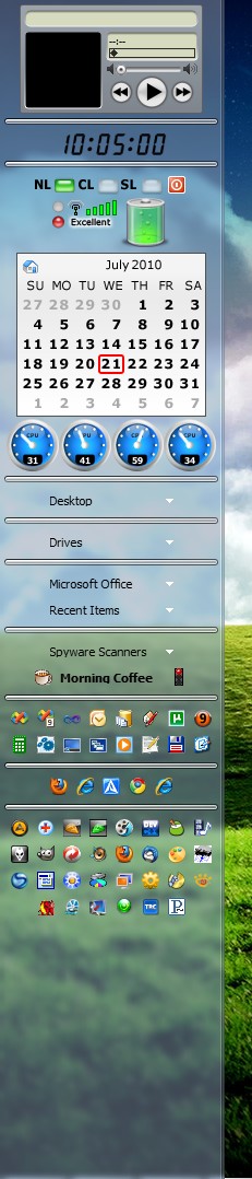

I have windows 7 x64 running TLB 4.4.11 RC3 on a dual monitor setup, whenever I reboot the TLB standalone bar on the left of the secondary monitor forgets how wide I had it set last time. The TLB standalone on the right of the primary monitor remembers its size just fine, they should both be the same size since they are both the exact same, quick launch bars. Can anyone help me with the setting I am missing?
Thanks a bunch,
Larry

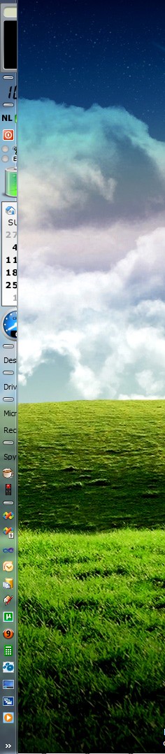

I tried the file, but it seems like it is not saving the size still. I rebooted a number of times and still no change. The steps I followed were rebooted, physically resized the bar then right clicked the bar and went to toolbar properties then clicked ok then rebooted and when it booted it was small again. I did this at least 3 times with the same results. One thing I did notice though, it seemed the menus when they popped out were the correct placement on screen, but the bar just did not fill that space on boot, so it was like the bar was 20 pixels wide on boot and the menu would popup 220 pixels away.
I did open the standalone.xml file and I can see it is writing the values for the left and right coordinates, but they are negative is that correct? I would have thought it would be 0 for left and like 220 for right if the bar was on the right, but maybe that is how it should be.
Thanks for your help,
