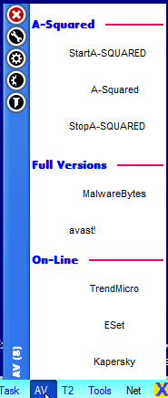

On the first instance, I tried to add a menu. ALL the icons in TLB disappeared EXCEPT the ones for two plugins I am using (calculator and port monitor). A reboot resolved the issue. Two days ago, I tried adding and then renaming a shortcut. The disappearance of icons happened again.
Since I had done each of these things many times over the last couple of months, I have only two suspects here. Either it is the Sophos tool or I am already infected with something via the rather large hole in Microsoft security. I am loathe to re-expose myself to the issue and the AV runs tell me I am clean. Thus, I leave the situation as is, knowing a re-boot (never a terrible thing, if time-consuming) will 'fix' things.

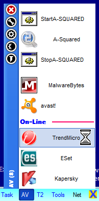

I think both graphics have been added. If it's only one, it's the after shot that shows no icons. I tried to rename one of the shortcuts.

NOTE: Both show. Good. However, I should also note that the problem didn't occur when adding the titles. It wasn't until I tried renaming that the issue cropped up.
