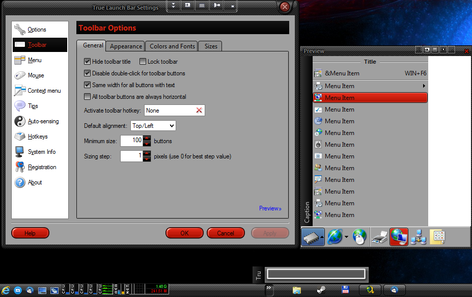

I just did a fresh install of Win 7 and TrueLaunchBar. I have a cmdline set to auto-hide on my main TLB bar. I also have the Windows taskbar locked. When I invoke the cmdline, the taskbar is not auto-sizing for the cmdline to appear (which it has always done in the past). What am I missing?
05-12-2012, 10:06 AM -
The option you have to increase is:
TLB Settings->Toolbar->General->Minimum size.
Set this option into something large (100) if you don't want the menu with two arrows.

That's not working - the empty space increases, but I still get the >> and the cmdline on a popup menu.

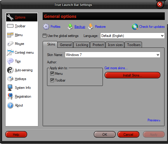

[attachment=1568]
(05-21-2012, 07:59 AM)Yuri Kobets Wrote: I've purchased WindowBlinds. I've reproduced the bug with the "Subline" skin.
Please try to set any TLB skin for toolbar. As I see this fix the problem.
Either I'm not understanding you, or it doesn't fix the problem. I tried setting the TLB skin to Clarity, Dark Glass, Grey Matter, Myriad and Windows 7. I still see the issue.
