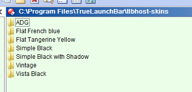

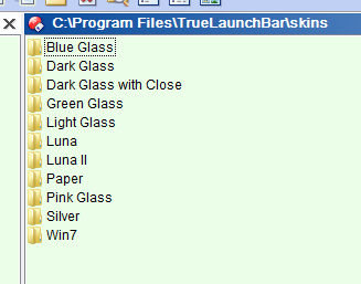

I see two skins folders - skins and tlbhost-skins.

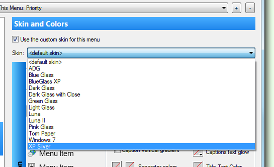

When I try to choose a skin, I am offered all of those in skins, and one that's in tlbhost-skins.
I want to use Flat French Blue, which is in tlbhost-skins, and so isn't offered.

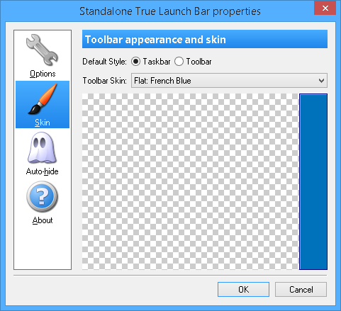

The "Flat French Blue" is the skin for Standalone True Launch Bar. If you are using the Standalone TLB, right-click the empty space of toolbar and select "Toolbar Properties". You can select skin on the "Skins" page (see the attached screenshot).

You can see from the attachments that I have two folders containing skins. Why 2?
There are about 18 skins.
But only 13 or 14 are offered.
I have set up a Standalone TLB which has Flat French skin. But I am still not offered Flat French for the menus which hang off that. Why is this? I go into the menu, right click and then choose Customise menu... That's right is it?

Even with Standalone TLB, the "Flat French Blue" skin does not change the menu appearance. This skin is only for toolbar.

skins - this folder is the main TLB skins folder. The skins from this folder can be selected in TLB Settings->Options->Skins
tlbhost-skins - skins for standalone toolbar. This is something like advanced background for toolbar.
