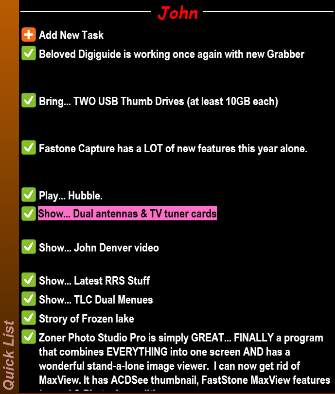

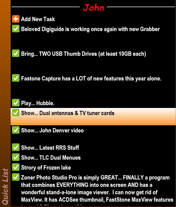

DocCruncher
10-09-2015, 06:46 AM -
(10-08-2015, 11:19 PM)Yuri Kobets Wrote: Looks like you have extra line breaks in the text because "Play...Hubble" have correct spacing. Try to edit the text and remove the line breaks: click, item, press "End" keyboard key and Backspace before the first letter.
Don't think that is what is causing the extra spacing.
SEE: Text Spacing 01 jpeg... when I click on the text I see nothing before or beyond the first & last characters of the text.
SEE: Text Spacing 02 jpeg... when I simply hover the mouse pointer over the text it shows a very high cell.
This started with the very first entry I made. I could not stop the high cell size so I deleted it and started over & the same thing happened.
There are no spaces before or after any of the entries.
It seems to be random as when it will happen but will repeat if I re-enter the same text in again. Once it does it with a certain string of text it always does it with that same string.
Most weird.

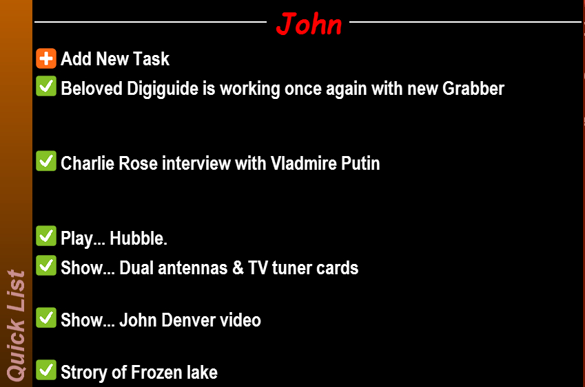

Just noticed the cells that are more then normal single cell height actually vary in height.
Notice the height of rows 2,3 & 4 compared to rows 6, 7, 8 & 9. 2, 3 & 4 are higher then 6, 7, 8 & 9.

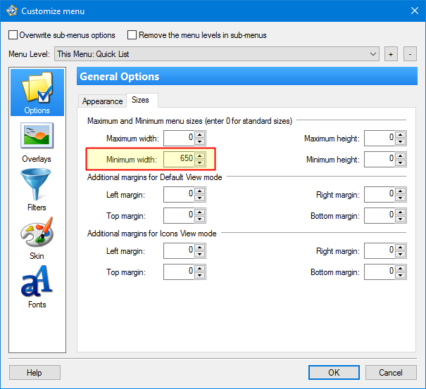

11-28-2015, 11:55 AM -
Sorry for delay.
The problem is in the option "Minimum Menu Width". I've attached the screenshot. If remove this option (set into 0) the items height become right.
Anyway I'm working on this problem.

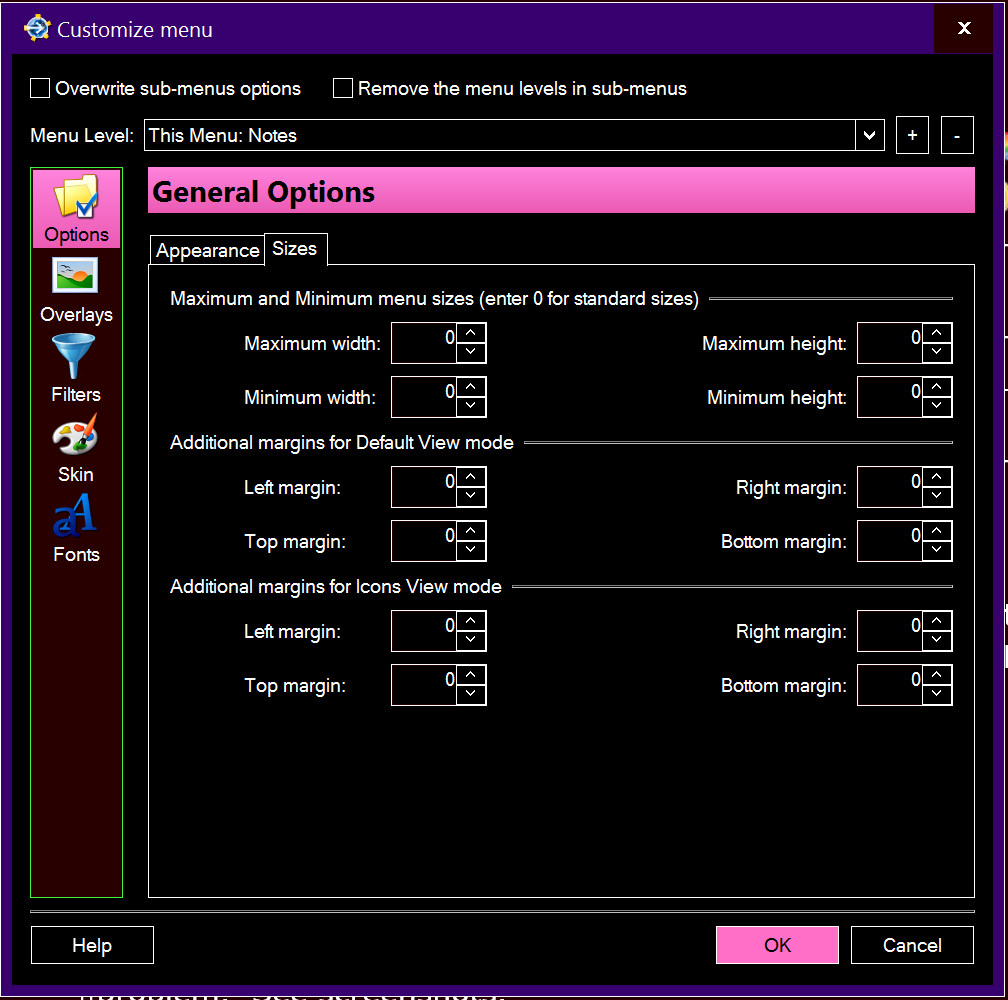

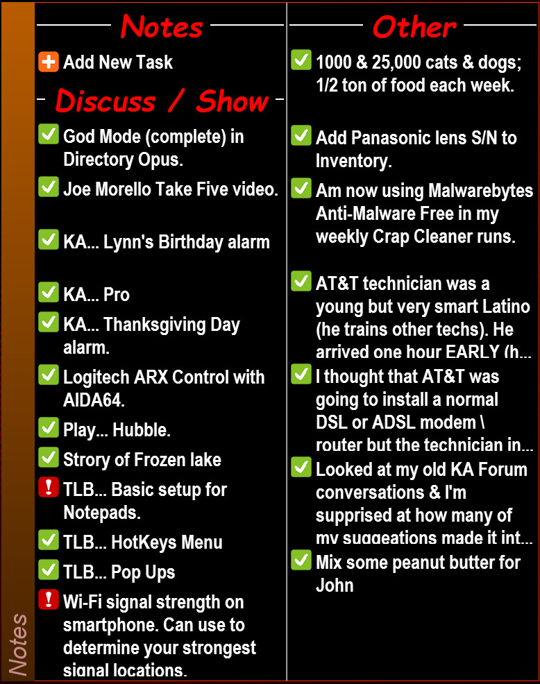

Hi Yuri;
Doesn't work for me. I tried setting all to 0, did a Refresh... same problem. See screenshots.
