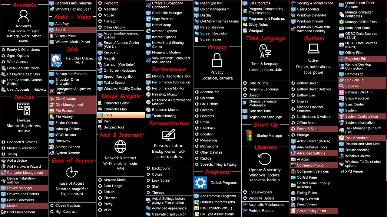

It's one of my custom pop ups (see JPEG). It also has a Hot Key of Alt A.
It used to only happen on a full normal Windows startup but is now happening on the Hybrid startup as well.

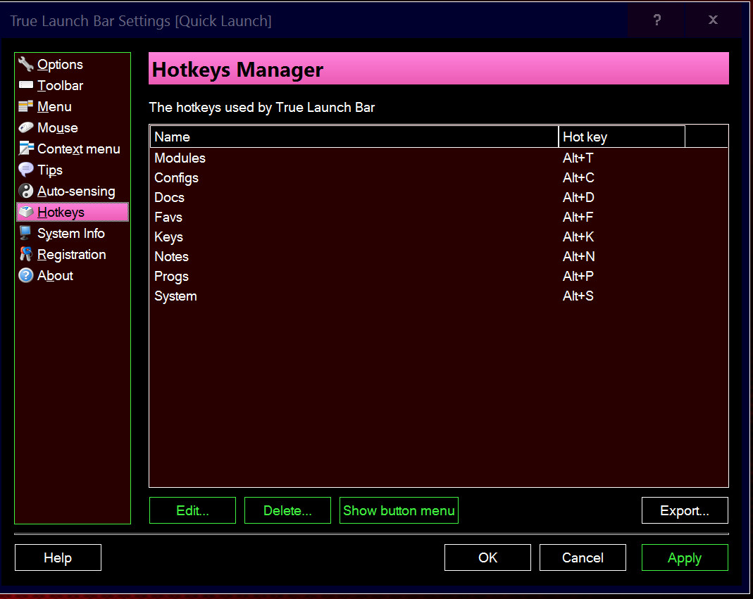

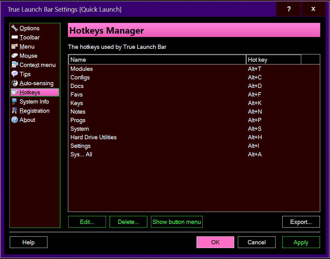

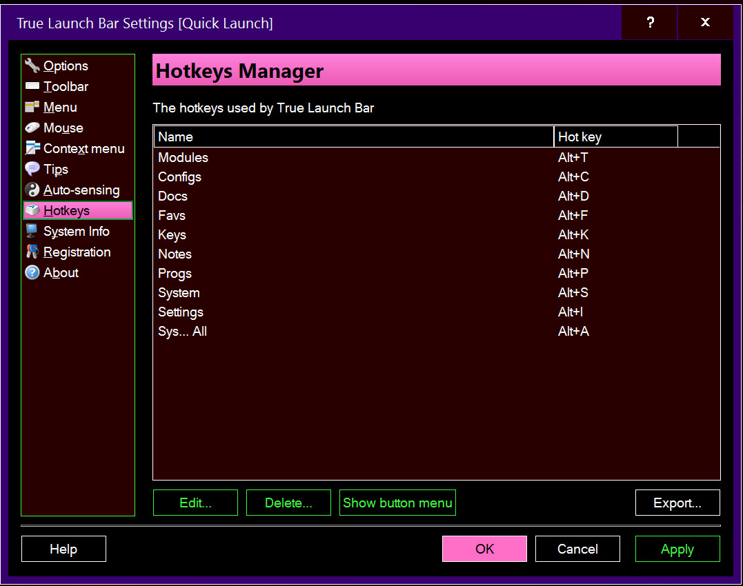

1: After Win 10 boot up only 8 of my 11 Hot Keys are accessible.
2: 10 Minutes later 10 of the 11 Hot Keys show up.
3: 20 Minutes after boot up all 11 of my Hot Keys show up.
4: The above is very repeatable as it is now happening on every boot up.
SEE: 3 attacked JPEGS.
