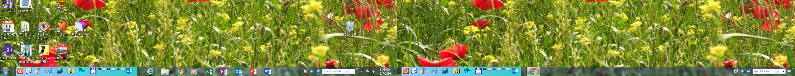

Yuri--I have a similar setup on my work machine which is currently Windows 7. I am attaching a screenshot that shows the primary monitor on the left and the second monitor on the right. As you can see TLB is on BOTH taskbars and it is Ultramon that allows this to happen. I think Win 10 has an advanced feature that may allow TLB to appear on BOTH taskbars without needing Ultramon but I am not sure.
The link to the Ultramon website clearly shows the feature of having TLB on both taskbars if you choose the "Smart Taskbar" option.
