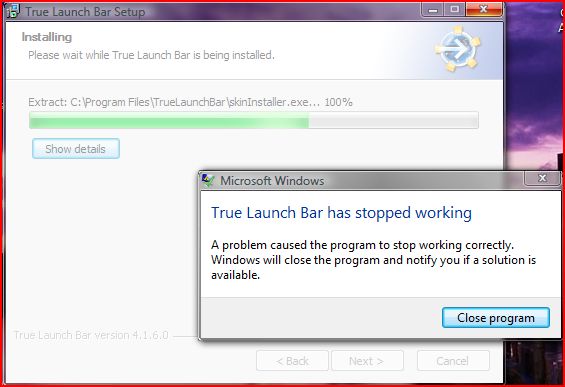

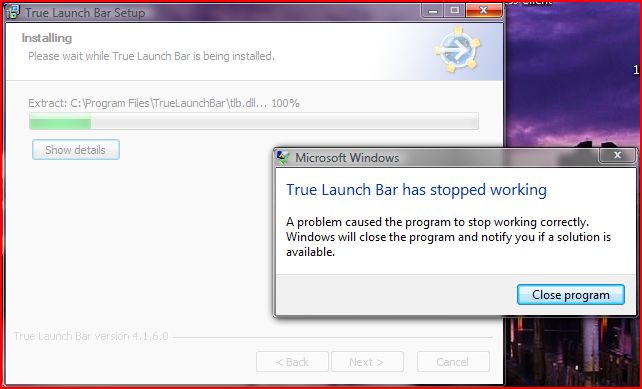

Not sure why, but I'm unable to install 4.1.6. I had 4.1.5 installed and tried to install 4.1.6 over it, but no luck. I then tried to uninstall 4.1.5 and had an issue, but finally got if off my machine. I rebooted, then tried to install 4.1.6, but still the same results.
It fails at the same point each time. (See "capture.jpg) I also noticed that it did manage to put a few folders and one file in Program Files (see "capture2.jpg").
Thoughts? :?:

03-17-2007, 03:51 PM -
Thanks for the quick reply Yuri. Unfortunately, still no luck. I did get a little further than before (see attached). But the installation failed again.
Thoughts?

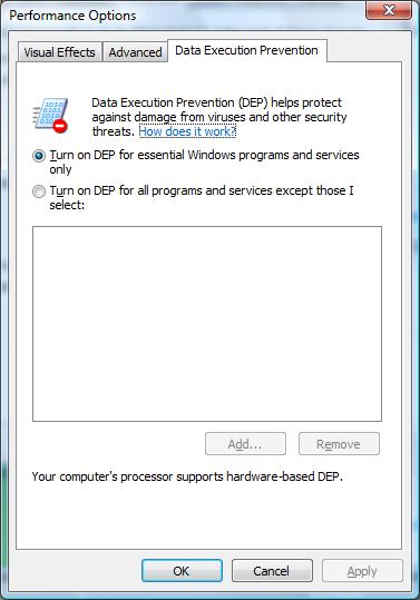

03-19-2007, 01:01 PM -
Please can you check the DEP state? See the screenshot.
You can find this dialog if press WIN+Break then open Advanced settings and in the dialog box click the "Settings" in the Performance group

03-19-2007, 06:26 PM -
That did it!! You da man!! 4.1.6 installed like a charm and is working wonderfully! Thanks again for all of your help and quick responses!!

04-03-2007, 01:30 AM -
I confirm that turning off DEP helps during installation/uninstallation. On my machine, as I identified that installer craches on tlb.dll registration.
I was able to reproduce the problem running regsvr32 tlb.dll
