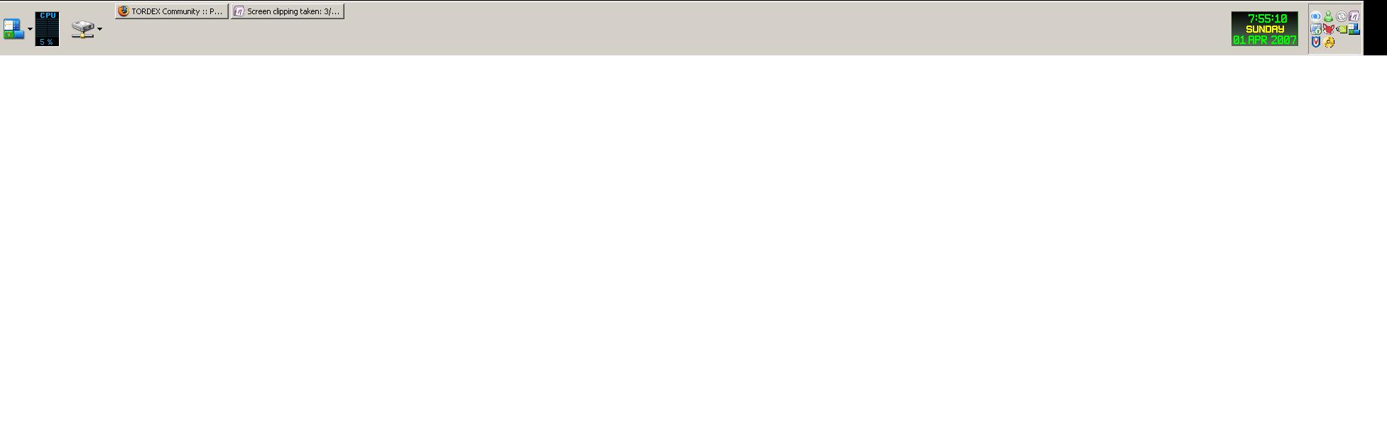

Also please post the screenshot of your 3 toolbars. Do you use tlbHost (Standalone True Launch Bar) or standard Windows toolbars?

Screenshot attached.
The problem happens even with just two bars. I added the third bar to see if it would help or change the problem.
I only get the main bar to appear after reboot.
04-02-2007, 10:32 AM -
I see two toolbars only Sad where is the third one? Or you have problems with these two?
