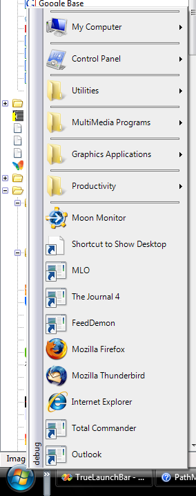

I started with a new toolbar, created a menu and used the pre-configured "My Computer". Then I created another and used the pre-configured "Control Panel". THe Control Panel menu set itself up inside the My Computer menu, making the My Computer icon on the taskbar disappear and replacing it with the ">>" symbol.
Why did it do that? I was trying to create a second menu that would be on the taskbar next to the My Computer menu. I cannot seem to create a separate menu - when I create the second one it always seems to go into the first.
Also, I experienced an explorer.exe crash while using the menu. I looked at the Event Viewer and saw that the explorer.exe crash I experienced yesterday was also caused by TLB. Screenshots of the errors below:
[Image: Screenshot-7_20_200712_57_44AM-1.png]
[Image: TLBHostUtilityCrash.jpg]
Any idea why this is occurring?
Thanks.
07-20-2007, 01:39 PM -
Quote:I started with a new toolbar, created a menu and used the pre-configured "My Computer". Then I created another and used the pre-configured "Control Panel". THe Control Panel menu set itself up inside the My Computer menu, making the My Computer icon on the taskbar disappear and replacing it with the ">>" symbol.
Objects always inserted before the button you right-click. There are two ways to avoid menu with ">>":
1) TLB Settings->Toolbar. Set the "Minimum size" into something large (50 for example). In this case TLB never show menu with arrows
2) Unlock the taskbar and set the toolbar width by dragging the right side (btw. you can move toolbar on the taskbar by dragging the left side)
To create the empty menu just type the menu name and leave the second field (path to the virtual folder) empty.
