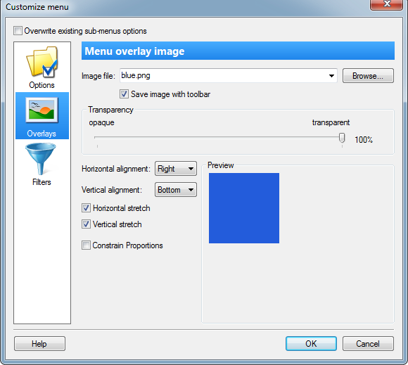

Actually you can change the menu background color right now with the overlay image. Create the picture (PNG, JPG, BMP...), fill the picture with the color you need and set this picture as overlay image with stretch. See screenshots.

Thanks. I see one screenshot, with blue.png. I do not know how to create such a png file. Could you post some in various colors?

Further, I created a background file, purple.png, which I am uploading. I went to a submenu and changed the overlay for the submenu as you instructed. The result was no change at all in the appearance of the submenu.

OK, I figured it out. In order to have the submenus a different color, you have to click on Customize Menu, not Customize Sub-Menu. Further, you must to this for every folder in the menu, which is very cumbersome for large menus.

OK, I figured out how to apply the new color to every submenu at once. You right click on an item in the menu and choose Customize Menu. Then, counter-intuitively, the change applies to all submenus but not to the menu itself. This is certainly not obvious.

Yuri has improved the latest version re this request. Now I can make all submenus have a different color from the menu itself by choosing Customize Sub-Menus and selecting a skin or an overlay. Thanks!
