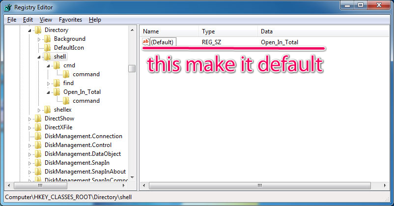

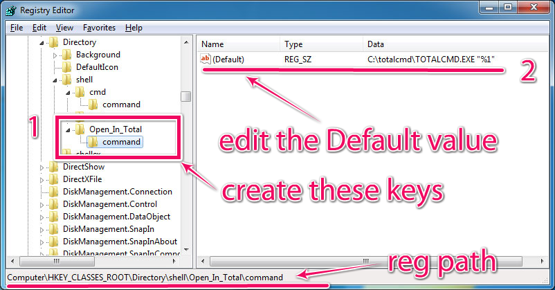

Any idea how to do this in Windows 7? Just switched over recently and having trouble finding a similar setting?
thx
s.newave
11 posts 4 threads Joined: Mar 2007
12-08-2009, 08:18 AM -
Anyone? Really can't use TLB until I can get this working.
Thx
12-08-2009, 09:06 AM -
It is possible to make the same effect by editing the registry. I've attached the screenshots of the registry changes.
s.newave
12-08-2009, 04:02 PM -
Works perfectly, tku!!!
