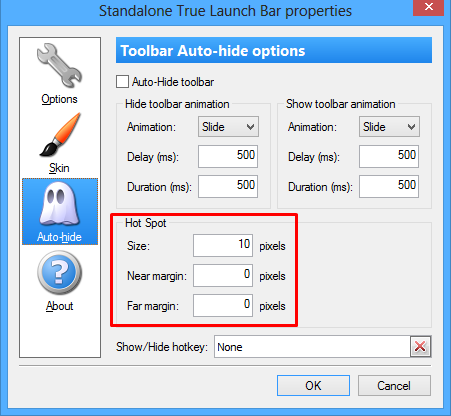

True Launch Bar have the special option for your case. Right-click the empty space of the toolbar and open "Toolbar Properties". You have to set the Hot Spot size into something greater then zero (look at attached screenshot).
How to return the toolbar back (if you can't to access it to right-click it):
First exit standalone True Launch Bar: right click eny toolbar and select "Exit". Find the file: %appdata%\Tordex\True Launch Bar\standalone.xml
You can delete this file and recreate toolbar after running Standalone TLB (the toolbar content will be saved). Or open this file with notepad (or any xml editor), find the srting
hotSpot="0"
and replace it with
hotSpot="10"
So you have 10 pixels at the right side of the screen to activate toolbar popup.

Thx Yuri - I was actually the one who asked you to explain the code for this severl months back! Smile
but I forgot about this functionality, as I only just started using the multiple monitor.
I Love my TLB! Thanks for clarifying how to use it best.
