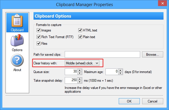

Yuri, I installed 5.2 on two Windows 7 Pro SP1 machines this morning, rebooted, opened Clipboard Manager Properties, selected the new Double click option, clicked OK, and tested on both machines. It doesn't seem to be working. I double-click the ClipMan icon in my TLB taskbar, and there's no deletion of the clipboard history.
I tried the middle-click option on both machines, and it works perfectly with a wheel click.

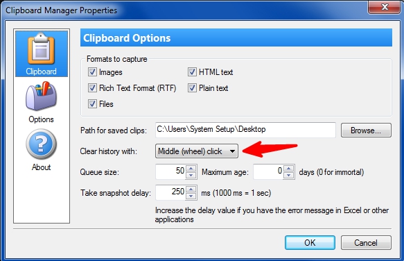

Quote:However for some reason I can not get the middle wheel click to clear the clipboard.
Did you select the middle click in the properties?
07-21-2013, 01:36 PM (This post was last modified: 07-21-2013 01:39 PM by gate1975mlm.)
Post: #7
RE: Clipboard Manager v5.2
Yes I did.
