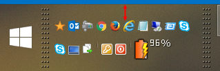

Hi. I am running TLB on Win 8.
With the previous skin I was using (Dark Glass), I was able to squeeze in 3 rows of icons into the quick launch toolbar area. After installing the Consis10C skin, I can only squeeze in 2 rows. For some reason, the skin adds a large top margin above the first row of icons - see screenshot.
With the previous skin, the top row of icons were almost flush at the top of the toolbar area.
I've tinkered with all the TLB settings but can't seem to remove the margin. Confused Any ideas?

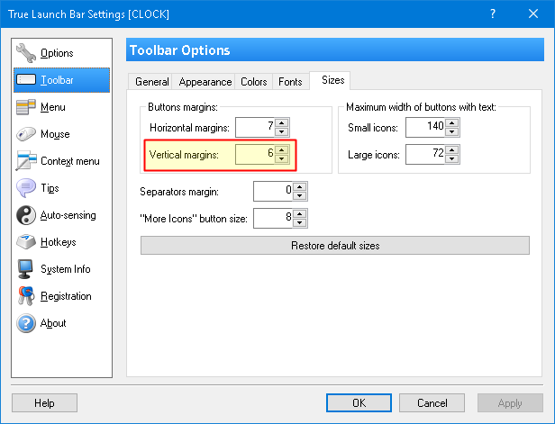

There are no any margins for toolbar itself. Only the buttons have margin. The Dark Glass skin have small margins for toolbar buttons. You can try to set the vertical margin for toolbar buttons in TLB Settings->Toolbar->Sizes. See the attached screenshot.
Also try to change the skin for battery monitor. This button is very large. TLB align buttons in the row by the largest button.
