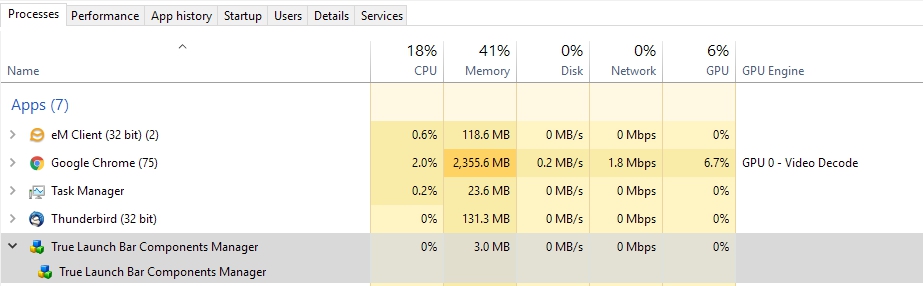

12-05-2017, 10:16 AM -
Please can you check if the process "tlbupd.exe" is 64-bit also. This process is executed when you click "check for updates". You can do this in the task manager. If it is 32-bit you'll see this in process name on "Process" tab of the task manager.
Also, are there the same problems with other plugins?

12-05-2017, 12:47 PM -
(12-05-2017, 10:16 AM)Yuri Kobets Wrote: Please can you check if the process "tlbupd.exe" is 64-bit also. This process is executed when you click "check for updates". You can do this in the task manager. If it is 32-bit you'll see this in process name on "Process" tab of the task manager.
After I clicked Check for updates I did see tlbupd.exe but it was under the details tab. On the Process tab I saw true launch bar components manager.
Here are screenshots.
Also so far I only noticed it with News Reader however I have not tried all plugins.

12-06-2017, 11:58 AM -
Thank you for screenshot. True Launch Bar Components Manager is what I've looked up.
I've reproduced the problem. It is seems as other plugins are working well. I'll try to fix this. Thank you.
