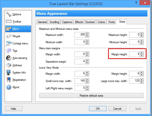

11-05-2013, 01:59 AM -
See the attached image. I've marked the option you need.
danmeek
11-05-2013, 02:03 AM -
My question was about spacing in a toolbar, not in a menu. Your advice does not work for that.

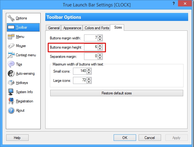

11-05-2013, 02:11 AM -
Sorry Blush
The toolbar have the similar option.

11-06-2013, 05:21 AM -
I am not trying to change button margin height; I am trying to change the space between items (such a text-only items) in a toolbar. I see that the buttons margin height setting does do what I want. I think you should change the label on that option to "Button or Line margin height"

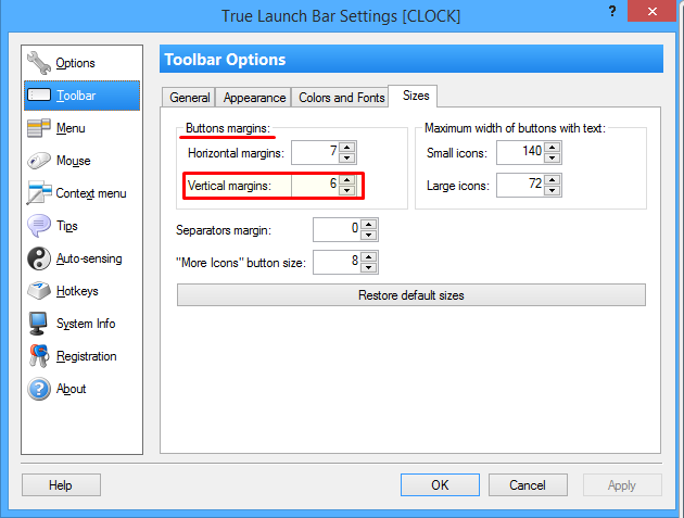

10-27-2014, 02:24 AM -
"button margin height" is still there, but with other name. Look at screenshot.
